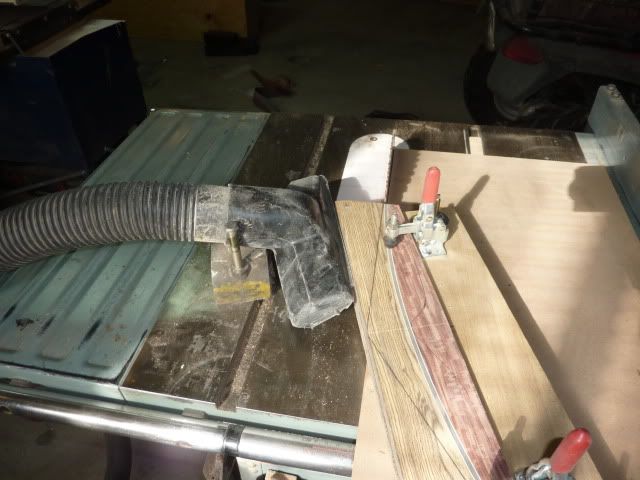

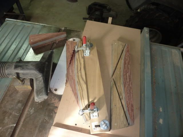

Time to start setting the table saw up to cut the limb bed angle. This is critical to get the blade square with the sled.
Ready to rockImage
The operation was a success

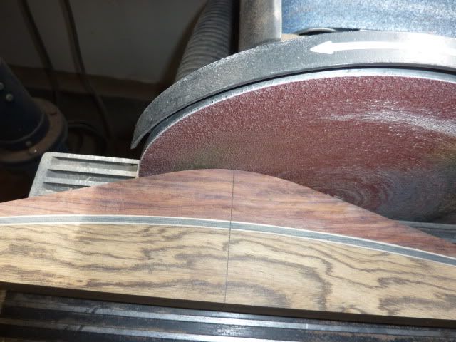

Rounding over the back to the layout line.
