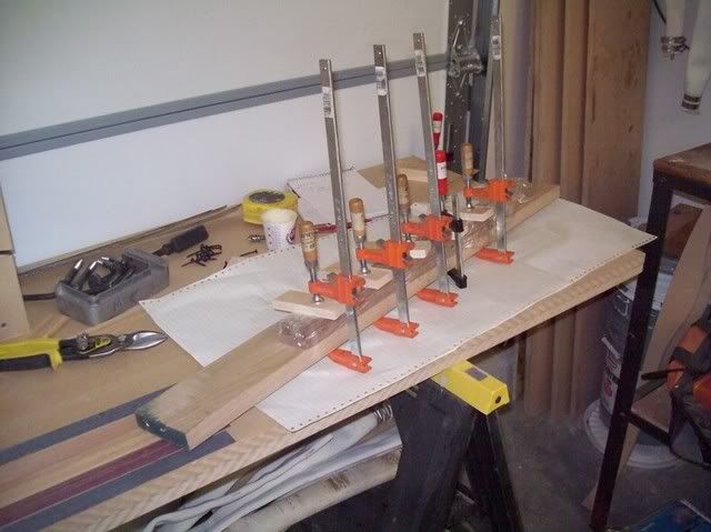

I could have started earlier, sorry. The lams are already cut and ground and I laminated a very simple riser up. I finished the kids form yesterday... I'll get this thing on the form later today...
The riser clamped and going into the oven...It walnut with a stripe of amarillo running back to belly...
