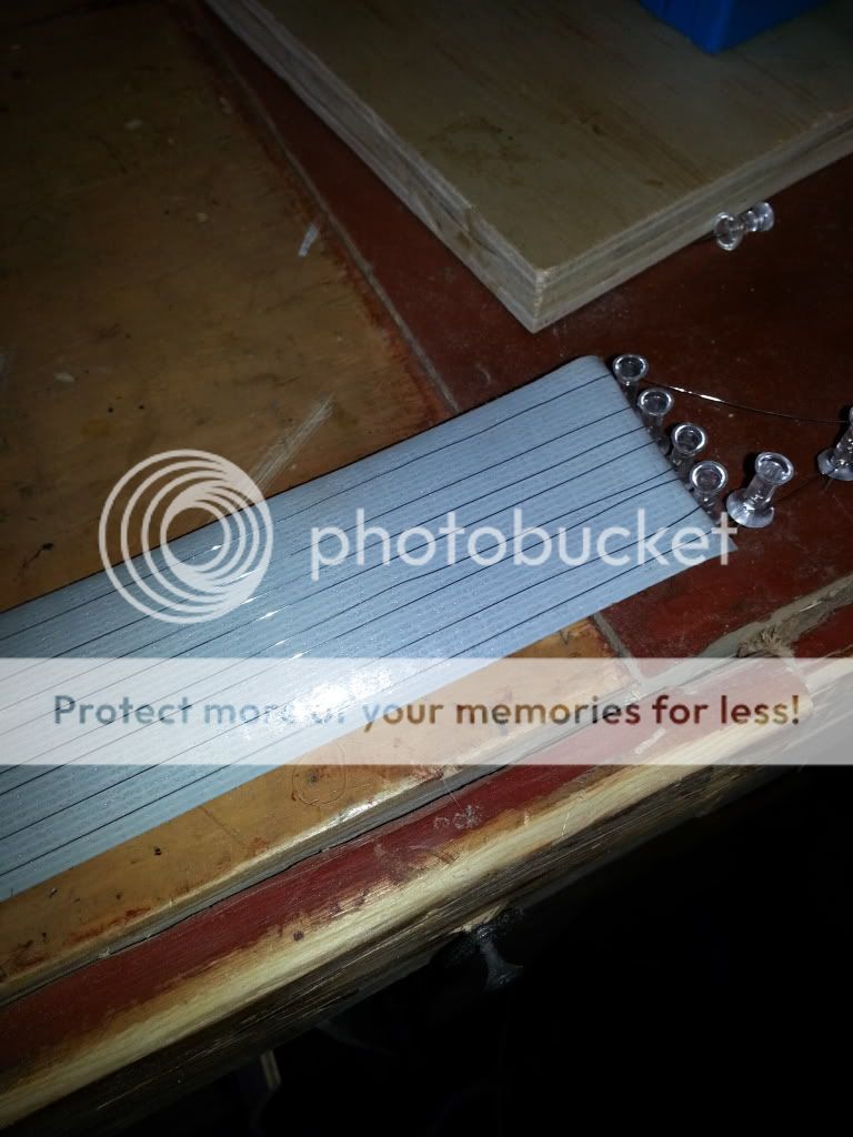

So no response yet from tattman so I ordered some nichrome wire and played with it a bit. Found out you can get it amazingly hot...just hook it to a thermostatic switch and it glows. Gave me an idea melt it into a piece of rubber so I took a bit and gave it a try..Image melted in fine after a bit and was able to cure some smoothon a little too quickly in the process. Now to get a proper rheostat to make it work at a proper temp. This is a short one which after cleaning up will be used for overlays.

Postby Chemsolder » Mon Mar 10, 2014 12:27 pm
Jon that was a small section I melted into a piece of rubber baseboard from a big box store it is a bit over 70" in wire there is a single wire but it runs across the rubber 7times. Was just playing around and glued a couple of scrap boards together using it, just a bit too hot. Tonight I will start prepping to make longer tapes for my form measure wire and do the math to figure out the power requirements. I picked up a rheostat but not sure what size transformer yet. Also thinking 10 runs should be easily doable. With proper layout.

Postby Chemsolder » Sat Mar 15, 2014 2:04 pm

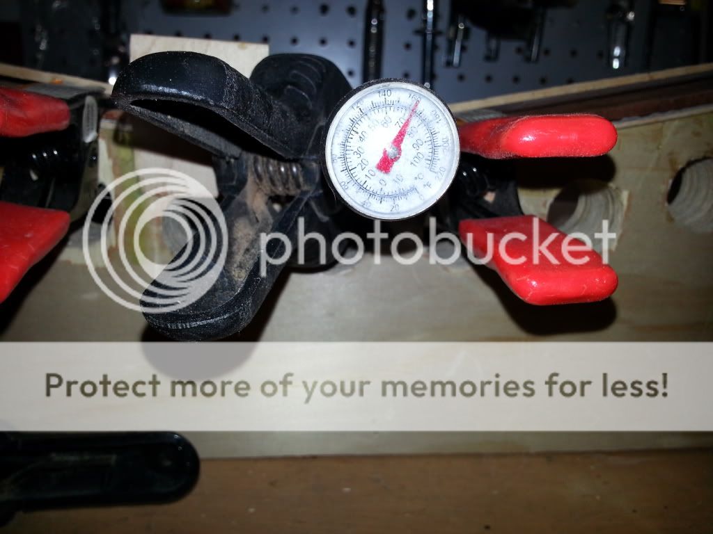

So success!!! I found that the maximum temperature that duct tape is ated to is 200 degrees....hmm I only want to go to 160-180 so I tried it and it works. The oly thing is if your tape is not covered it will overheat in the area it is not covered in, has to do with the ability to transfer the heat away from itself and all that science and math.
What I did is completely unsafe and not for the careless, wreckless, or those without good insurance!
So I took and laid out my nichrome wire 32awg on the duct tape, then put another piece of tape over that but left the ends exposed.
On those exposed ends I put a small piece of brass rod and wired my copper wire to that.then I covered it with duct tape as well. This is not a UL listed tape and is not intended to insulate wires, a job that it must do if you are to go without shocking yourself in this endeavor.

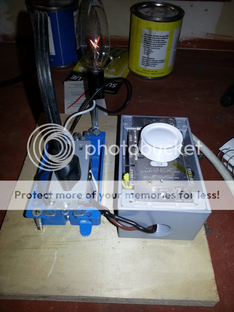

The power source is simply a dimmer switch (the one that only works with halogen and incandescent lights) and a plug. I also incorporated a light so I can tell it is on and the intensity. It is much SAFER to INCLUDE A TRANSFORMER and not wire this up directly as a direct wire means each strip of nichrome is now carrying 110v...not safe but it does heat
So I had everything on my shelves at home but the nichrome and dimmer which together costed less than $20 for enough to make a few long heat strips and several smaller ones. I think I prefer the strip I melted in to the rubber then just added tape over the side the wires are on, but both work.
