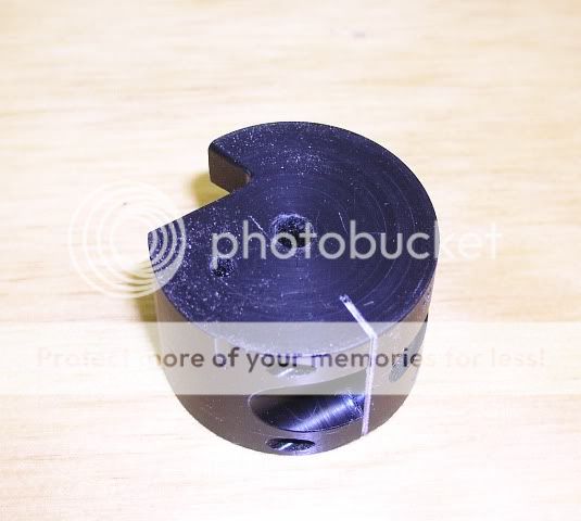

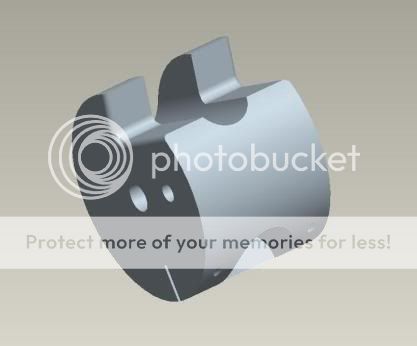

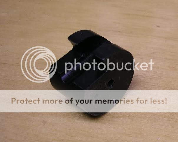

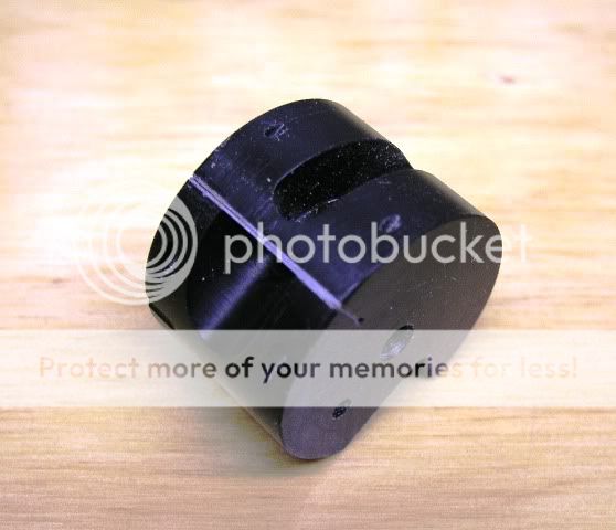

Ok, where were we? Hmmm. Let's look at the roller nut. Alchem sells acetal nut blanks cheap, but they are 1.5" dia. stock.
If you are using the 1.5" Dia. forstner bits to cut the pocket, it might be a tad tight. I just brought in a 3 foot length of Delrin (high grade acetal). Keith is making nuts to a design we came up with that cures all the problems I had following the Alchem design.
This nut is turned down less than 1.5".
The hole for the 3/16 dia. axle is honed.
The .030" sear plate (metal plate that makes contact with the trigger) is hardened steel (we use two .015 thick pieces because they are so damn hard to drill).
The plates are held in place by two roll pins which can be removed if the plates wear.
The string needs to be centered on the bolt. A groove has been added to help achieve that.
There is a pocket machined into it for the quick reset pin. Without the pin, everytime you re-load the bow, you would do the thumb dance where you spin the nut until it was in a position for the trigger to reset via the return spring.
Bottom line is Keith is making these in small batches and they take some time to make. They will be for sale in the near future.
