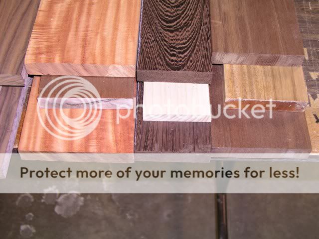

The plan: Add a Ben Pearson style dead center prod to a hybrid Alchem style tiller.(Stock is for rifles, Tiller is for Trad CB)
As the BP prod has a longer power stroke, the nose (front) is longer.
I am so confident this is going to work I am doing a batch of six.
The three on the left are spoken for:
1. Purpleheart/Yellowheart center board (Bill)
2. Red Oak/Bubinga centerboard (Mark)
3.Br. Rosewood/Ash centerboard (Me)
Yo, Trux. Pick from the next three:
3. Santos Mahogany/Peruvian centerboard
4. Wenge/Ash centerboard
5. peruvian Walnut,Teak centerboard

I do like the looks of that wenge! I'm excited to see what you come up with.

I agree with Trux,that wenge wood is pretty cool.I'm going to have to get some of that stuff.

Wenge looks incredible when finished. It is however a bitch to finish with those crater sized pores...so much so I rarely use it anymore even though it is beautiful !!!

The tiller does not have the stresses of bows. The prod is serious business. The tiller is a blank canvas to use all that other stuff. I just have to look at the wenge and splinters appear in my hand.
