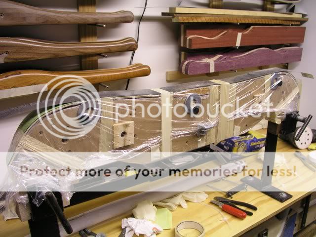

Wrap form with shrinkwrap (stuff used for wrapping goods on pallets).
See the "1-10" scale? 4 (2 + 2) was perfect for 2 glass 3 lams and riser.
record the event.
glue-up. Sorry, no bow snot allowed on my good camera. Use your imagination.
This was not easy. Need to re-think a pin concept.
Hog-tied and ready for the hose. Second wrap and pressure strips. Did not have a one-piece 1 3/4" long enough so I used two for the td forms.

Slow air-up to 72lbs. Too much? Too little?
In the oven. Out at 8:30 EST.
