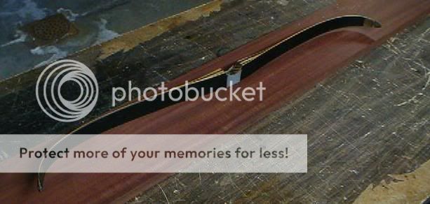

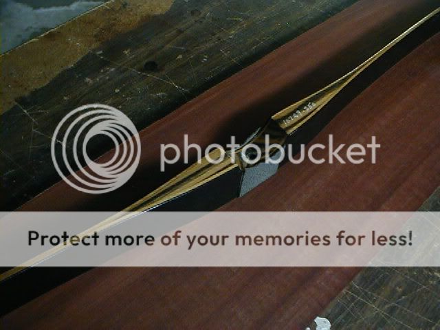

I am trying to reproduce a Ben Pearson laminated prod for a new crossbow project. This post covers the form to date.

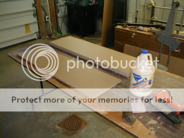

Starting out with 2 pieces of 1/2 thick mdo and one piece of 3/4 thick mdo for a 1 3/4 wide prod.
Building the sandwich with Titebond II.

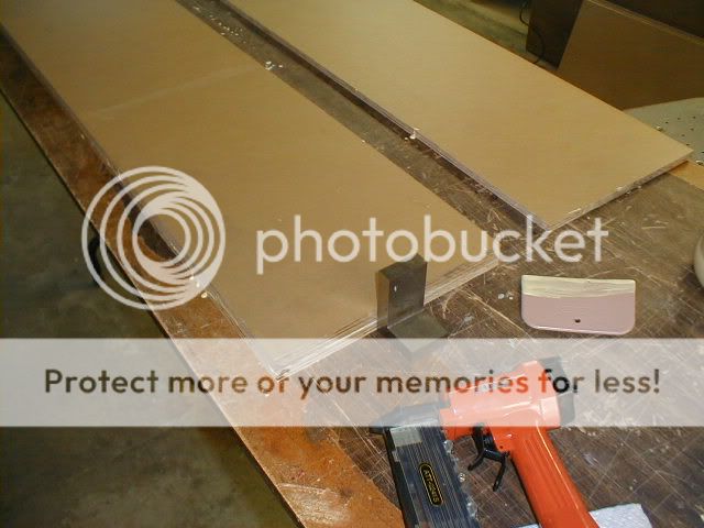

A couple of brad nails on the center line to keep layers from floating around.

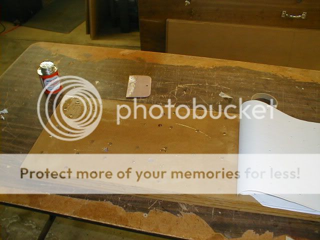

Tape the pattern on and center punch with a finishing nail for locations of form bar holes and form screws.
Screw both sides together using 8 x 1-1/4 Deckmate star drive screws. Run screws into the form. If heads stick up, they will hinder sliding the form on the band saw table. Have warm wet paper towels ready to to clean up squeeze-out.

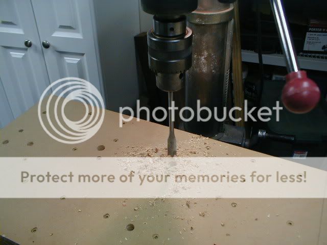

Drill form bar holes using 7/16 and 9/16 spade bits.
Glue pattern onto form with rubber cement.
