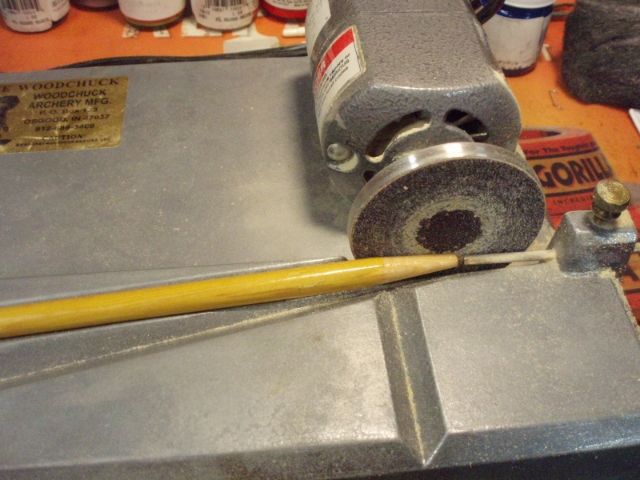

Once they have been dipped and crested it is time to install the nocks. Before I glue them on I clean up the nock taper. By now they have 3-5 coats of various stains and dips on them and it is hard to get a nock on straight. I run them through my Wood Chucker to grind off all of that paint and get it back to bare wood. This gives me a good, clean, true surface to install the nocks on. If I am shooting Florescent nocks, I will generally then just dip the nock cone in some white paint and let it dry. Then I will glue on the flo. nock. It makes the nocks glow 10 times brighter in the woods.

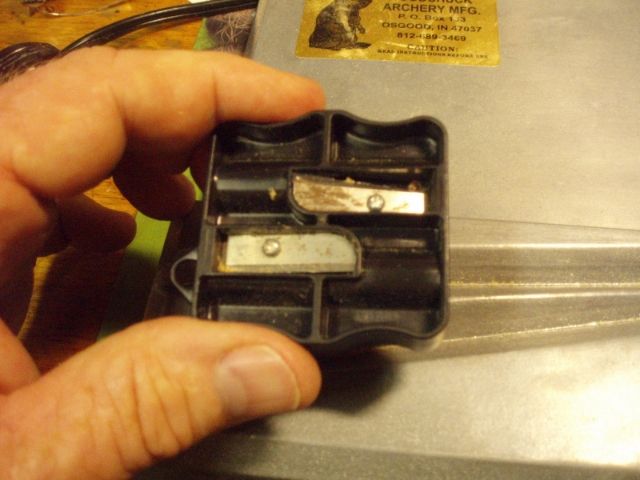

There are several tools on the market from Bear Paw and others to put a taper on your arrows. The simplest and cheapest is the simple pencil sharpener type of taper tool. They are manufactured by several companies and have two holes for you to insert the shaft into, one for the 11 degree point taper and the other for the 5 degree nock taper. This is one of the disadvantages of the Douglas Fir shafts. These pencil sharpener type of taper tools do not work too well with them. They tend to chew through the wood instead of making a smooth cut like they do on cedar. Here is one of the cheap taper tools.

This is the best taper tool out there. It grinds on a perfect taper, regardless of wood type. This one is called the Wood Chuck and runs about $150.00. If you do more than a couple of dozen shafts each year, this tool is well worth the investment. I have bought two of them at swap meets in the last year or so for $50.00 bucks each.
