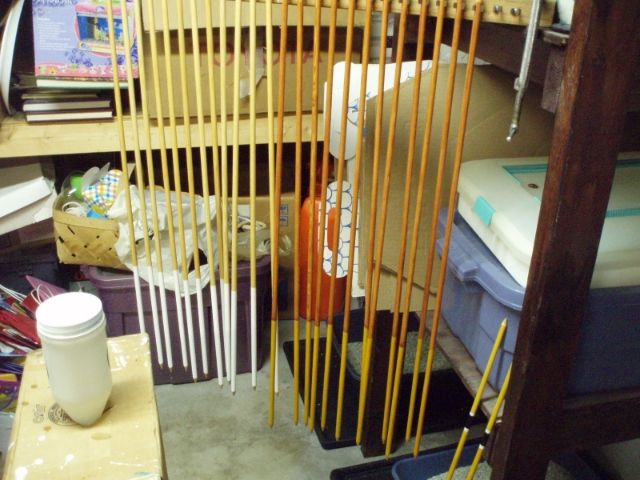

Now it is time to start sealing the shafts. Guys use a lot of different products for this. I have used Bohning Clear & Blue Clear both before and had excellent results. I know some guys like to use gasket shellac, Min wax Poly and several other things. I know that a lot of the pros have their own secret mixture and a lot of them use Dally's Pro-Fin, which is a deck finish for boats. The last several years I have used Bohning Super Coat. You are supposedly able to get away with using only one coat. I like it because it gives me a tough, gloss finish and I get very little target burn on my arrows when I use it.
I dip the full length the shafts. I have utilized several different contraptions over the years for this. Everything from a piece of pipe with a cork driven in the end to commercial dip tanks. In my opinion, you are heads and shoulders ahead of the game to just go on and spend the $13.00 on one of the Big Dipper dip tubes. It is sealable with a screw on lid and the reservoir holds a lot of liquid. I leave the shafts full length to dip them as that leaves a short "handle" on the end for me to hold on to. It doesn't get the coverage that the rest of the shaft does but it is going to be cut off when I trim the shaft to length and taper it.
Posts: 3646
Re: Wooden arrows... a build along.
Postby Stykshooter » Sun Jul 21, 2013 12:31 am
A suggestion here... have some way to support your dip tube. I use a tall box that I cut a hole in the center of it. I have had one turn over on me, making a monumental mess, and I know of two of my friends who have had the same thing happen. Just to make it easier, some guys use a wipe on finish or brush on the finish.
I full length dip the shafts and then hang them up to dry for about 12-24 hours, whenever I can get back to them.
I hang them in a home made rack that I built using the metal arrow clips. Works well.
You notice that I am doing the dipping in a corner of the "dungeon" of our house. A storage/junk room in the basement. Most of the year I like to do this out in the garage due to the very offensive odor. During the summer months the humidity is so bad down here that If I try and dip out in the heat and humidity, it ruins the finish. It will either crinkle or turn milky. The temperature was 94 and humidity was in the 90's when I dipped these shafts. When the conditions are like that I go into the "dungeon" where I have a dehumidifier running. I like the finish to be thin enough so that it runs off and stops dripping in about 5 seconds or so. I then hang the shafts up and let them dry. Then I steel wool them again, wipe them down with a rag that is damp with lacquer thinner and dip them again. I like to do this until I have three good coats on the shafts. Some guys like to do more, some less. Three gives me a good, protective finish. I like them to be completely smooth, high gloss and look like they are covered in glass.
