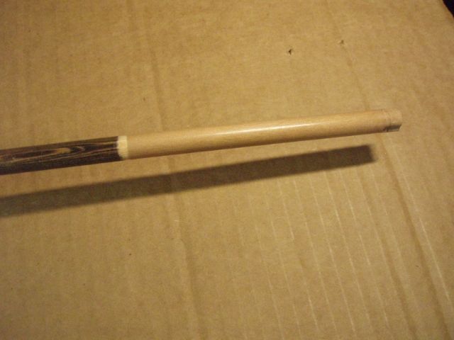

Postby Stykshooter » Mon Nov 20, 2017 6:56 pm
I just finished up a dozen woodies for... ME!!! I wanted some classic looking arrows for one of my longbows...
classic woodies.JPG (136.3 KiB) Viewed 1114 times

Postby Yohon » Tue Nov 21, 2017 6:11 am
Good lookin arras!!!!
Posts: 3718
Re: Wooden arrows... a build along.
Postby superkodiak38 » Tue Nov 21, 2017 11:03 am
They're purty for sure, shame some critter is gonna possibly roll over and break one ;)
