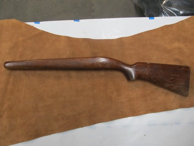

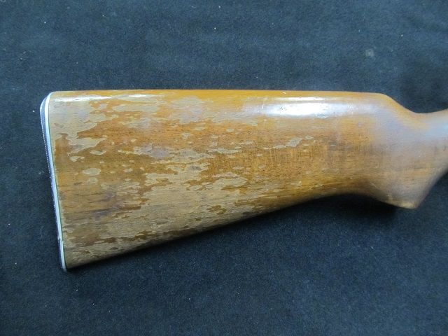

One of my hobbies is restoring old firearms and I have restored some of my Fathers firearms in the past but until now I had kept my hands off his 721 but after the 2014 deer season, myself and other members of our hunting party got to talking about his 721. It was decided I would give that tired rifle a make over. In the last few years, my oldest brother would take my Father’s rifle back to his house after deer season to clean and oil it so it was not out of the ordinary that the 721 would be out of sight. During the annual Christmas at the farm I got the 721 and set about the restoration. Like all my restorations, it begins with the “before” pictures. As you will see, there is little original finish left on the wood and the bluing had been polished away leaving silver metal which was once a deep black. Despite the lack of blue, the rifle has little to no rusting.
Now you have good understanding of what I’m dealing with. Little to no finish and little to no bluing and a few dents and dings and 50+ years of old oil and crud.

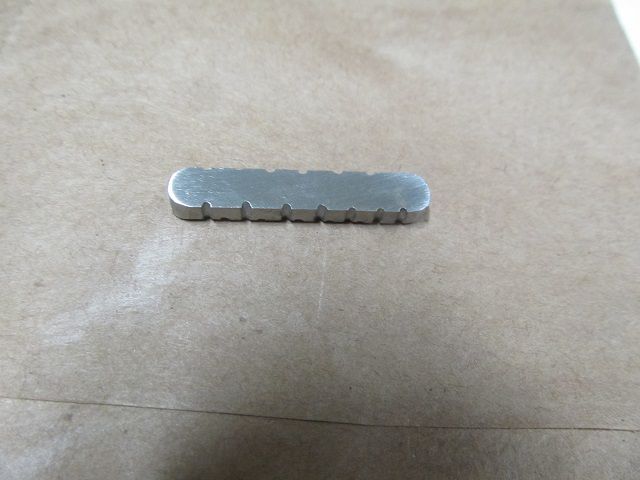

I wanted to bed the stock in the location of the barrel lug so the barrel would float above the stock. Over years of tightening the action screws and the lack of finish, the stock had swelled and is now in contact with the barrel.
With a bit of epoxy and some steel I remedied the issue with the barrel lug. Now the lug rests squarely against embedded steel rather than old wood.
In the past I have done restorations with either cold blues or boiling water Herters Belgian blues but for this rifle, I thought it best to send it out for hot bluing. Before sending it off, I disassembled and polished all the metal rather than have the bluer do any of the polishing. Because the bluer would have the action for quite a while, I turned my attention to the wood stock. I planned to rub in a dozen or so applications of oil and they would have plenty of time to cure between applications.

After sanding I applied a bit of filler for the pours in the freshly exposed walnut.
