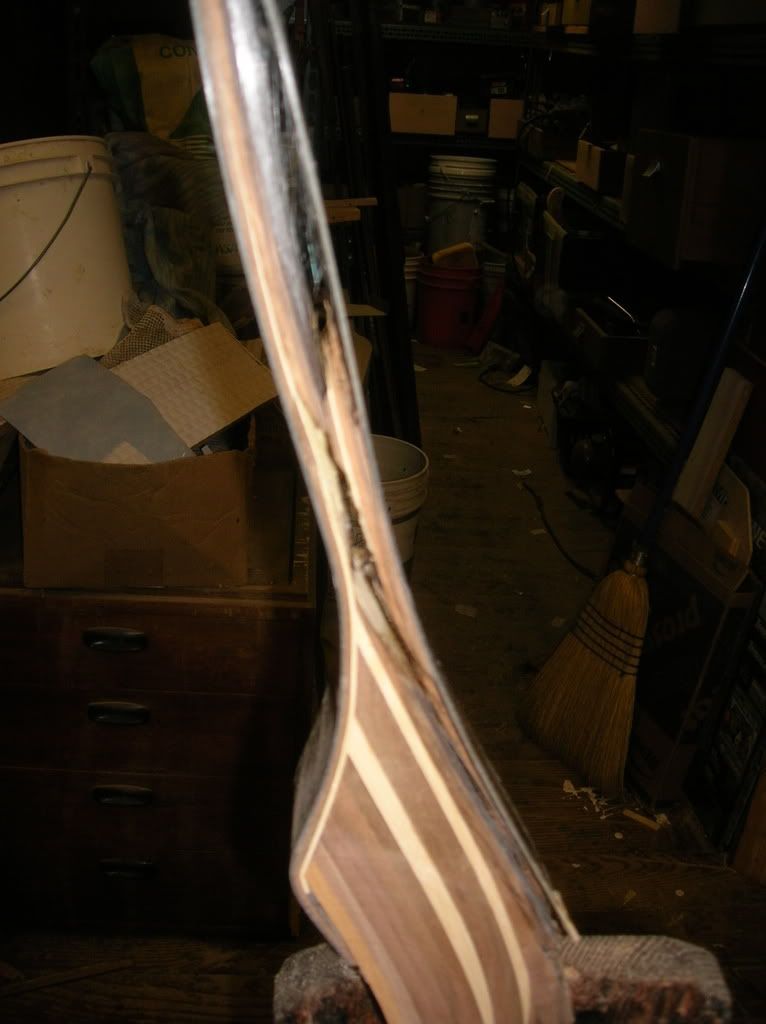

Got Bones?
Re: Sneak Preview on Prototype 1st entry for WTT III
PostPosted: Fri Jan 30, 2009 1:53 am
by GraemeK
That one must have had some bend near the handle.
Better luck next time
Graeme

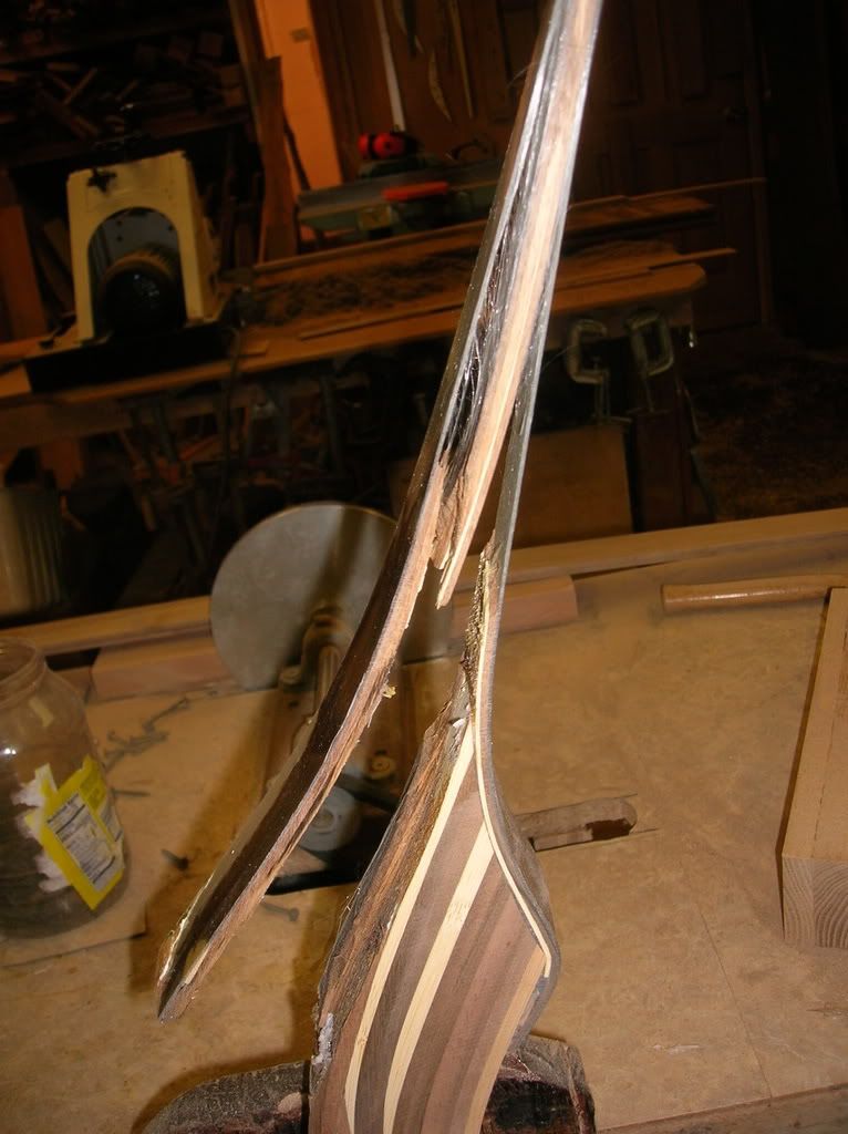

PostPosted: Fri Jan 30, 2009 1:37 pm
by Kenro
KA-BANGG!!!!!!!!!!! :lol: Man I love that sound!! :lol: as long as it aint mine. :P Hey bro , you know Im laughing "with" you not "at" you. Im sure with the changes discussed in bucket time you will have the next one rocken!!

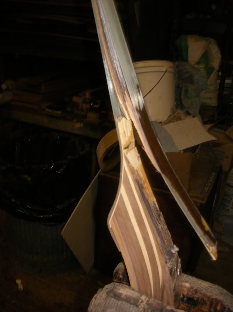

Gino Bruno wrote:that sucks buddy!!! hope you still have all your body parts in tact.
yup.... the first limb that blew was pretty benign....now the second limb i had to put it in a vise and work pretty hard to get that one to blow. :o i got my info, but i sure wish i'd have worn a leather gloves... :oops: my hand was numb for a good ten minutes....longer fades and a power wedge fixed up the design error....got a shooter out of the next one....number 3 out of the form hopefully will see Wisconsin.... 8-)
PostPosted: Mon Feb 23, 2009 9:55 pm
by Kirkll
i already did get the riser bugs worked out bro.... i cooked this one here at to high of temp and used white glue on the laying up.... there was a design flaw too, and had to extend the fades out some.... i've got some zebra i'm bending for the next one.... i'm hoping for less excitement on this one. :D
