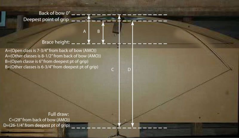

This can be confusing, so I am posting this explanation and illustration to show the way we will set up the bow pulling rack and shooting machine at WTT4.
Our published procedures...
EVENT TESTING PROCEDURES FOR 2010:
(same as 2009 unless we vote to make changes)
...3. Strings will be provided for all the bows in the regular classes. If you are entering a bow for the open class, you must provide a string of at least six strands that will brace the bow to a minimum of 6". The bowyer must also specify what brace to use if more than 6" is recommended for that bow. The other classes require a minimum of 6-3/4" brace height on all bows...
All classes of bows will be pulled to 28" AMO, which is 26-1/4" from the deepest point of the grip.
On the bow weighing rack, there will be a stop collar on the pulling cable to keep bows from pulling farther than 26-1/4" from the deepest point of the grip. (This corresponds to 28" AMO which is measured from the virual back of the bow which is 1-3/4" from the deepest point of the grip.)
On the shooting machine, the mechanical release will be set to release the string at a fixed distance of 26-1/4" from the deepest point of the grip. (This corresponds to 28" AMO which is measured from the virual back of the bow which is 1-3/4" from the deepest point of the grip.)
On the bow weighing rack, on bows in the "Open" class (with a 6" brace height), the string will appear at brace at 7-3/4" on the ruler on the bow pulling rack.
For all other classes (with a 6-3/4" brace height), the string will appear at brace at 8-1/2" on the ruler on the bow pulling rack.
All classes of bows will pull to 26-1/4" from brace height, which will appear at 28" on the ruler on the bow pulling rack.
The illustration below should illustrate this.
