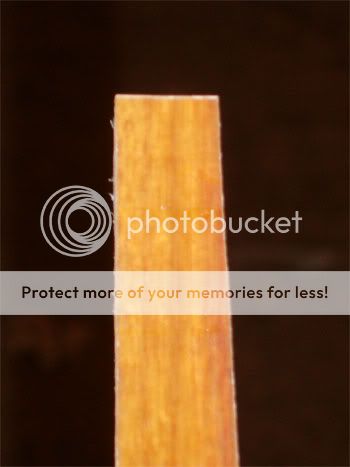

Crap...just read the swap rules....has to be strung. So tips it is. I had some fancy ideas in my head that I've never tried before. After a LOT of thinking I decided to play it safe. I'll experiment on one of my own bows.
.09" Rosewood over .08" Phenolic tips. I clamp them together and pre-grind one end to facilitate blending into the limb.
I need them to bend a bit to conform to the limb so I don't pre-glue them.
Dry-run clamped to the limb. I had to use 2 hands to get these suckers bending enough. Good to go.
I only want to mix up smooth-on once so I do the riser overlays at the same time. Rough out 11" of the glass behind the riser. I forgot a picture of the dry-run, but I always do one to be sure they lay flat.
Popsicle stick in the drill to mix up some smooth-on. Easy cheesy. BUT if you get any on the tip of your drill you REALLY should clean it off right away with soapy water if you plan to ever use the drill again.
