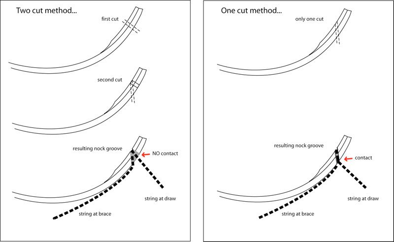

Here's how I mark and file the nock grooves using the "two-step method." Here's how it works...
First I marked the back one inch from the tip, then took the line all of the way around the tip.
This time I went a head and made three cuts with my micro hack saw from Sears. Just through the surface...about 1/32" deep so it will guide the file.
Next, I tried filing the grooves with a dremel tool like someone on here suggested. It didn't work worth a darn because it wanted to jump around and chip the wood overlay.
So, I filed them with my rat tail file. This one is 6" x 1/4" and just a little too big so I only used the tip. I'm trying to find one that is 4" x 1/8" but can't find one locally. I may have to order one but it will cost $8 for shipping the $4 file...makes you want to say "hmmm?"
So, here's the first cut on the side.
Measure and mark for the second cut. I make a mark across the belly about 5/16 to 3/8" from the first mark on the belly, then mark the angle on the sides. Double check when done to make sure the angles are going the right direction...lol. Don't ask...
Making the second cut. File it so there is only one file width where the two cuts meet at the back.
