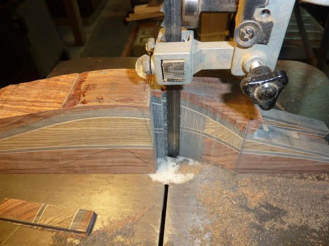

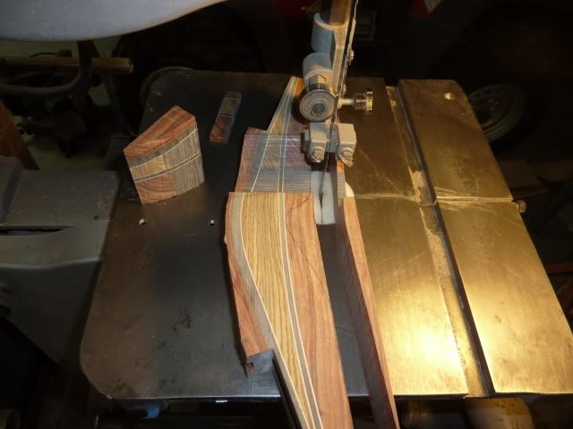

Profile and window laid out, off to the band saw.
Cutting out the window making sure to leave meat in the corner for a 1/4" radius

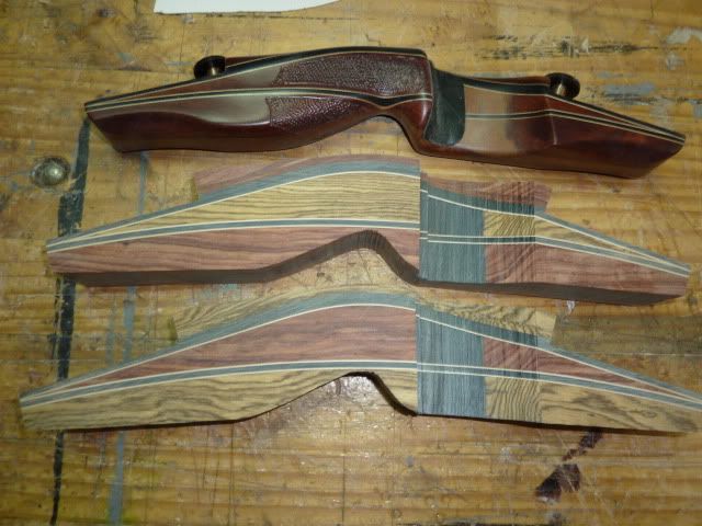

Now there starting to look like something.

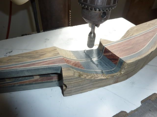

I chuck up Hogitha in the drillpress and start shaping the shelf.

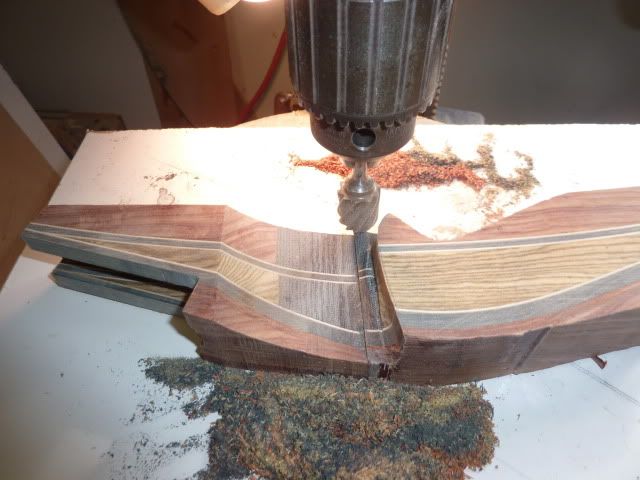

Next I surface the arrow pass.

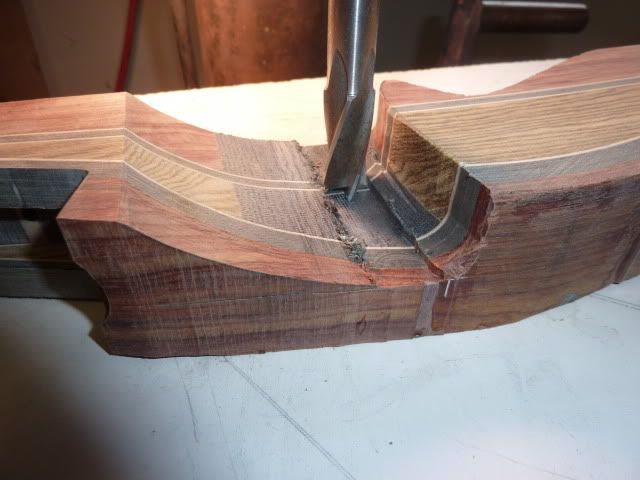

Then finish with a 1/2" bur file.

Well finally done.
4 coats of thunderbird, let dry 72 hours then a dusting of spar varnish to nock the sheen off and now there ready to send to Alaska.
