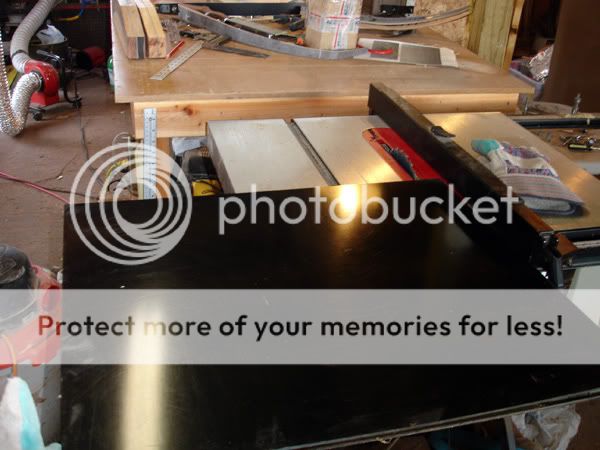

Now I need to line each pad with some phenolic so I'm gonna rip off a 1 5/8" strip.
1 5/8" because even after cleaning up and squaring the risers, they are still 1 5/8" thick. At some point I'm going to have to take off another 1/8" or so. Cross that bridge when we get there I suppose.
Grind off the glossy release agent.......and walla! One for each pad.

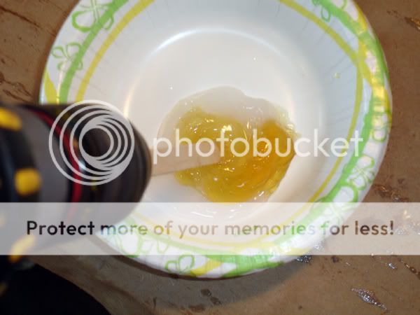

If you're not too anal retentive you can have smooth-on for overlays mixed in about 2 minutes......
A spoonful of each, just eyeball it.
Scrape off spoons (looks like an egg :? )
Drill mix for 45 seconds.....done!
This is about twice as much as needed for the 4 pads by the way. I had a couple other "things" that needed gluing as well.
