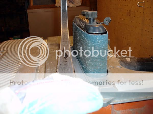

I still need 2 more tools....a drum sander and a big-boy edge sander.....someday :roll:
Until then I use the edge sander Ibex sent me a while back.....I get the feeling
this sander has seen a LOT of bows....
You'll notice that I sand down to the OUTSIDE edge of my line. That's because I'm a wuss.
See, I'm leaving myself an out....a safety valve. Once I get a string on it I'll check for twist
and have 1/16" on each side to adjust if need be. If it lines up good, then I'll just grind
down to the inside of the lines.....or leave it, depending on weight.

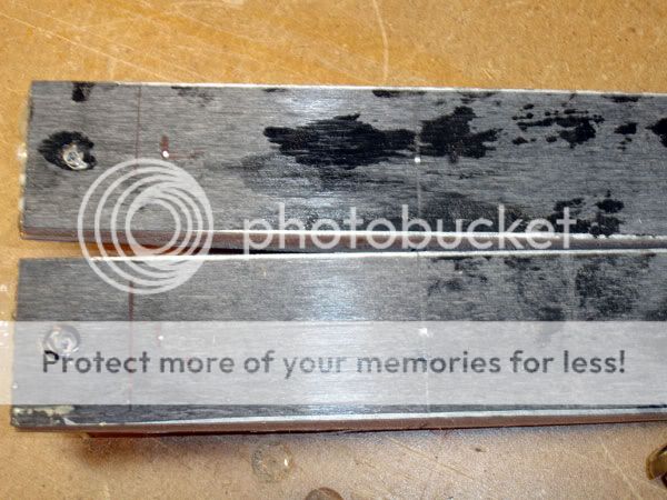

Marking for ILF hardware.
The black left line will be the limb butt.
The left silver dot is the center of the limb bolt slot.
Right pencil line is the rocker & silver dot is the center of the bushing.
It was getting kind of late so I decided to leave it until tomorrow and remeasure everything
before drilling. I really don't want to make a stupid mistake here.

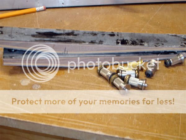

After remeasuring everything every which way but Friday, I drilled. Okay, I drilled 2 small pilot holes then hung a string on it again to make sure they were still lined up. We're good on both limbs.
Next was to take it to the drill press and make damn sure the limb was square to the bit. I used the cutoffs from when I made the wedges to keep the limb from rocking. Drill 3/8" holes.
Install bushings.
Re: Bowswap ILF Buildalong - 4 4Nolz
Postby BK in TEXAS » Tue Aug 03, 2010 7:31 am
I wanted to see how everything was working so I slipped a Donkey Insert onto the bushing. feels about right.
Checking to see if the bolt hole lines up with the insert......sweet :)
