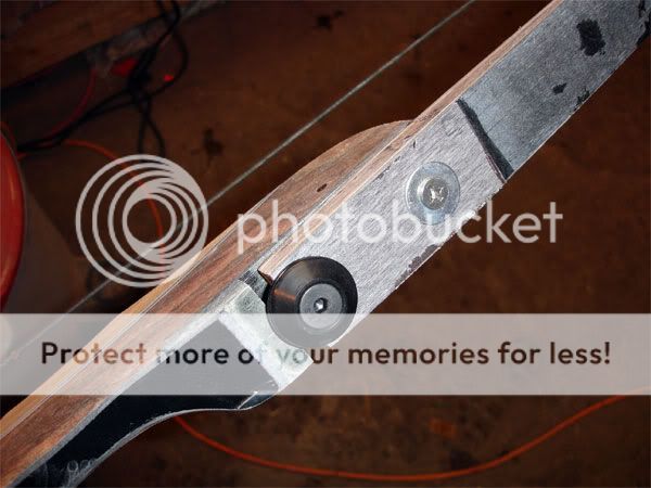

OK so I ran into a little problem....see that nice little bolt & bezel?
Apparently once I added the .05" brown glass overlay it was enough to make the damn bolt too short for the threads to catch. Now I gotta find a bolt with the right threads 1/8" longer....grrrrr. I managed to temporarily mount it with a steel washer at least so i can keep working on it.
I also noticed that I could have put my overlay "bump" closer to the limb bolt and closed that gap a little. Oh well...live & learn.

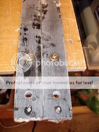

Here is where I ran into a little problem, or I $#$@$&!% up, however you wanna look at it.
Somehow I managed to miss truing (squaring) one of the rocker wedges. Probably because I was doing 2 bows at once and taking pictures, but still.....one side is about .04 thicker than the other. That's a LOT! It wasn't really noticeable unbraced I suppose because the limb was resting more on the dovetail bushing than the limb itself. Once braced, the limb is going to lean, and most likely twist. Had I mic'd both edges of both rockers I would have caught it. Let that be a lesson to me :roll:
Since I needed to sand out at least .04" from one side to fix it, I had to apply a belly overlay.
All in all this was a major pain in the @$$ to fix, and a lesson I won't soon forget.
