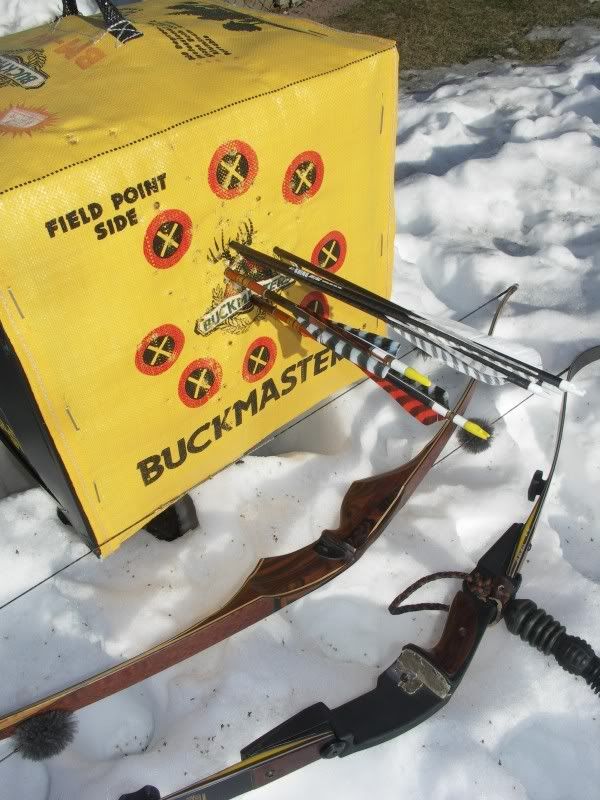

i decided to shoot a few after lunch with the heavier limbs...... i picked up my bow and nocked an arrow..... at that point i noticed my notes on the lower limb that gives the brace and tiller that i have the bow set up for....... it dawned on me right there that i had not adjusted the tiller on these limbs when i changed them out yesterday.... turns out, i was running 3/16" negative tiller and had the back out the upper limb 1.5 turns from the light set (which i also have written on my limb). i just started laughing and made the correct changes.
i then also grabbed my 65lb hybrid that i use for strengh work and shot 5, 2 arrow groups with it at 20 yards.... then picked up my titan and shot 10, 3 arrow groups with it...... problem solved...... note to self, i am a retard.
here is the last group with the hybrid and the first group with the titan.

By the look of the grouping you did get it figured out. Guess it was you forgot to factor in the "DUHHHHH" when you changed the limbs out.
